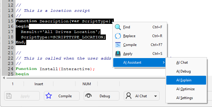

Script Editor
Within the script editor window you can access various A.I features:
ScriptEditor
AI Chat: Lets you chat to AI about anything. See AI Chat below.

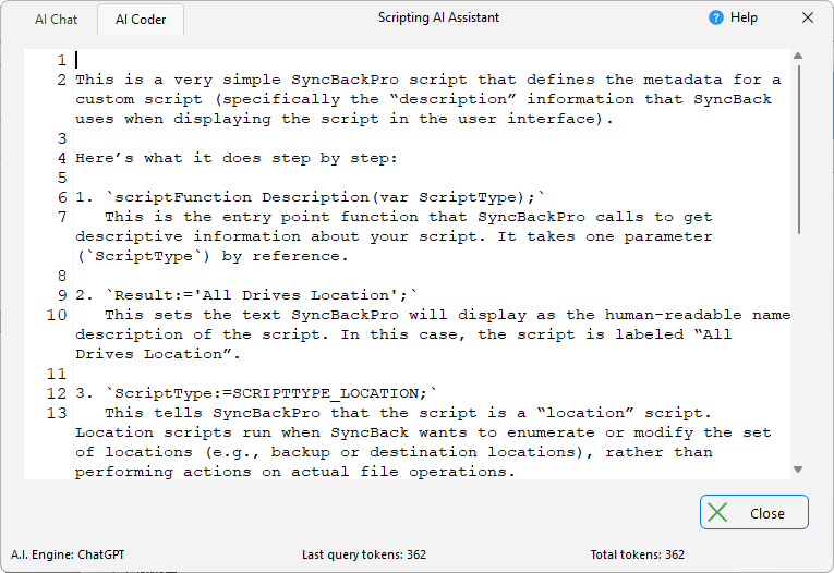

AI Debug: If you have selected some code in your script, then choosing this will ask AI to try and find any bugs in that section of code. The AI Coder window will appear with the result.
AI Explain: If you have selected some code in your script, then choosing this will ask AI to explain the code. The AI Coder window will appear with the result.
AI Optimize: If you have selected some code in your script, then choosing this will ask AI to try and optimize the code. The AI Coder window will appear with the result.
AI Settings: Lets you define which AI engine to use (see AI Settings below).
Each of the above modes (except AI Settings) also has a Detailed variant that provides the AI with the complete SyncBackPro scripting reference for more accurate responses. See Detailed Modes below for more information.

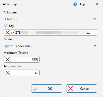

AI Engine: SyncBackPro supports three A.I. engines: ChatGPT (Open AI), Claude (Anthropic) and Gemini (Google).
API Key: For SyncBackPro to access the AI Engine, you need to create an API Key. Refer to their documentation for details on how to do this.
Model: If you are using ChatGPT then you will be able to choose the model. Typically, models have different balances of cost and time, e.g. ones that need to reason for a longer time may give more accurate responses but will typically be more expensive. Refer to their documentation for details on the models.
Maximum Tokens: If you are using ChatGPT then you will be able to specify the maximum number of tokens that can be used. Artificial intelligence tokens are simply small pieces of text that an AI uses to read, understand, and generate language. They are the basic units the AI works with, much like letters and words are the basic units of reading and writing for people. A rough, easy rule of thumb: 1 token is about 4 characters of English text, 100 tokens is roughly 70 to 75 words. In short, AI tokens are the “bite-sized” pieces of text that artificial intelligence uses to think in language.
Temperature: If you are using ChatGPT then you will be able to choose the temperature. Note that not all models support a temperature. If they do not, use 1.0. The AI temperature is a setting that controls how predictable or creative an artificial intelligence model is when it generates text. In simple terms low temperatures give accuracy, stability, and reliable facts. High temperatures give creativity, variety, and unexpected ideas. The “temperature” does not make the AI smarter or dumber; it simply adjusts how adventurous or conservative its word choices are.

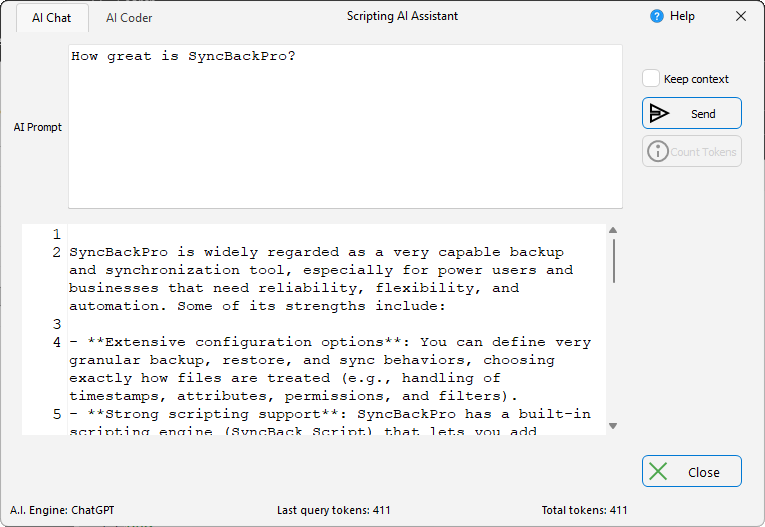

AI Chat
To simply chat to AI, first make sure you have configured it using the AI Settings (see above). If you have, enter your question in AI Prompt and then click Send:
aichat
The response will be appended to any previous answers and SyncBackPro will automatically scroll to the end of the responses.
Keep context: If enabled, it tells the AI to continue the same conversation instead of starting over, preserving short-term memory, consistency, and context.
AI Coder
The AI Coder page is shown when you highlight code in the editor and then choose a menu-item from the AI Assistant pop-up menu, e.g. AI Explain:
aiexplain
