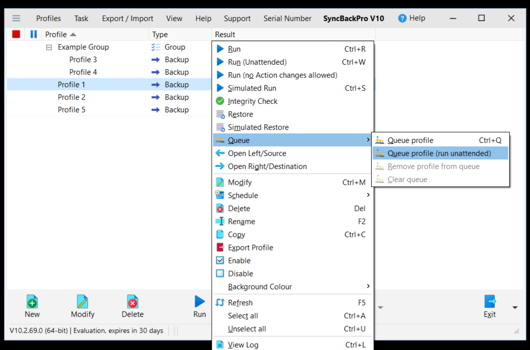

First, let's add Profile 1 to the queue. Right-click on the profile. As we have nothing in the queue it will start immediately. Let's run it unattended.

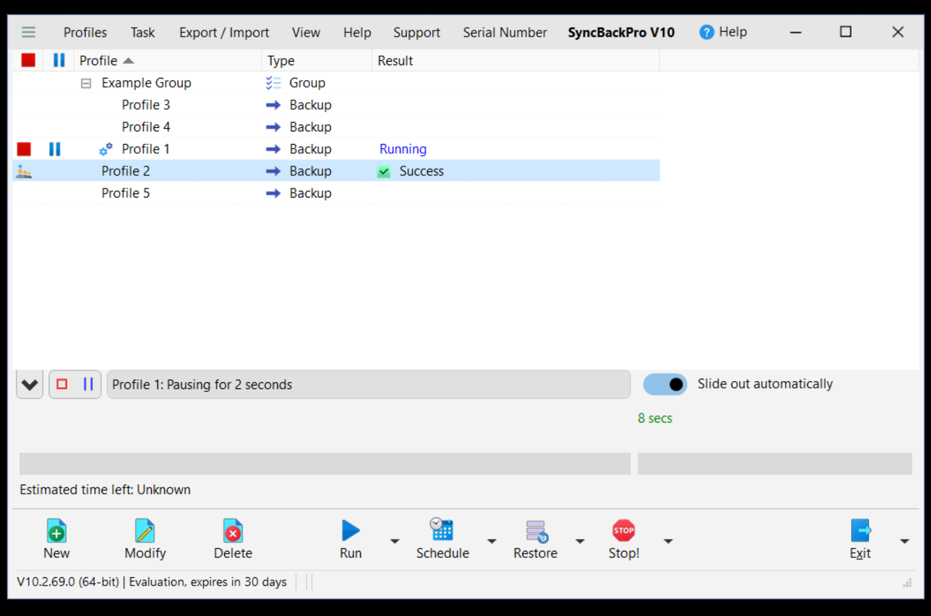

While it's running, let's add Profile 2 to the queue. Once Profile 1 has finished it will be started. The icon to the left of the profile name shows it is in the queue.
Now we add Example Group to the queue. This means Profile 3 and Profile 4 will also be run as they are part of the group.

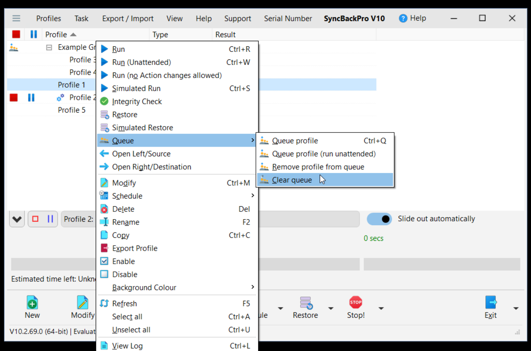

You can also remove all profiles from the queue by right-clicking and selecting Queue -> Clear queue from the pop-up menu.
