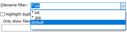

As you type the search criteria into the text fields FindOnClick will present the eight values previously entered. To view or select your previous eight search entries click the down arrow to the right of the Filename Filter and move your mouse over the entries. Press Enter to use the value.
Note that you can switch off the search criteria history from the Options menu of the main interface. |
Press Reset to clear the search history and search parameters. These will then be reset to the default settings.
